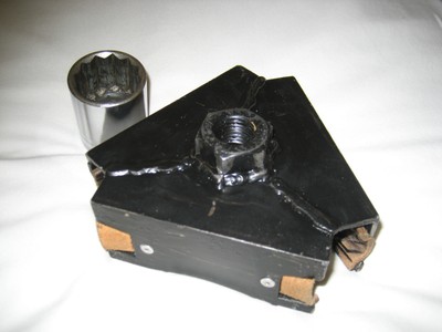

Is the top pair of photos from a current eBay listing?

catsx11 wrote:A man of your talents could 'knock-up' something similar to these?…agnoraan wrote:...trying to find a less brutal way of trying to get them undone...
http://www.lotuselan.net/forums/tool-ta ... 30392.html
Thanks Alan, are you inside my head again ? I was thinking the exact same thing, that I could knock something heavy duty up to do the job, as shop bought ones seem to be mega bucks
cheers...Nige

catsx11 wrote:Nige you probably spotted it, but the second photo was to show how another tool design 'hooks' around the back of the spinner
You don't want it to slip.
Thanks Alan, yeah, I did spot that and wouldn't be too hard to replicate. I'll wait and see what the guy says about the one I spoke of above first though. At £45.00 it's way cheaper than all of the others that sell for £200 upwards.
cheers...NIge
