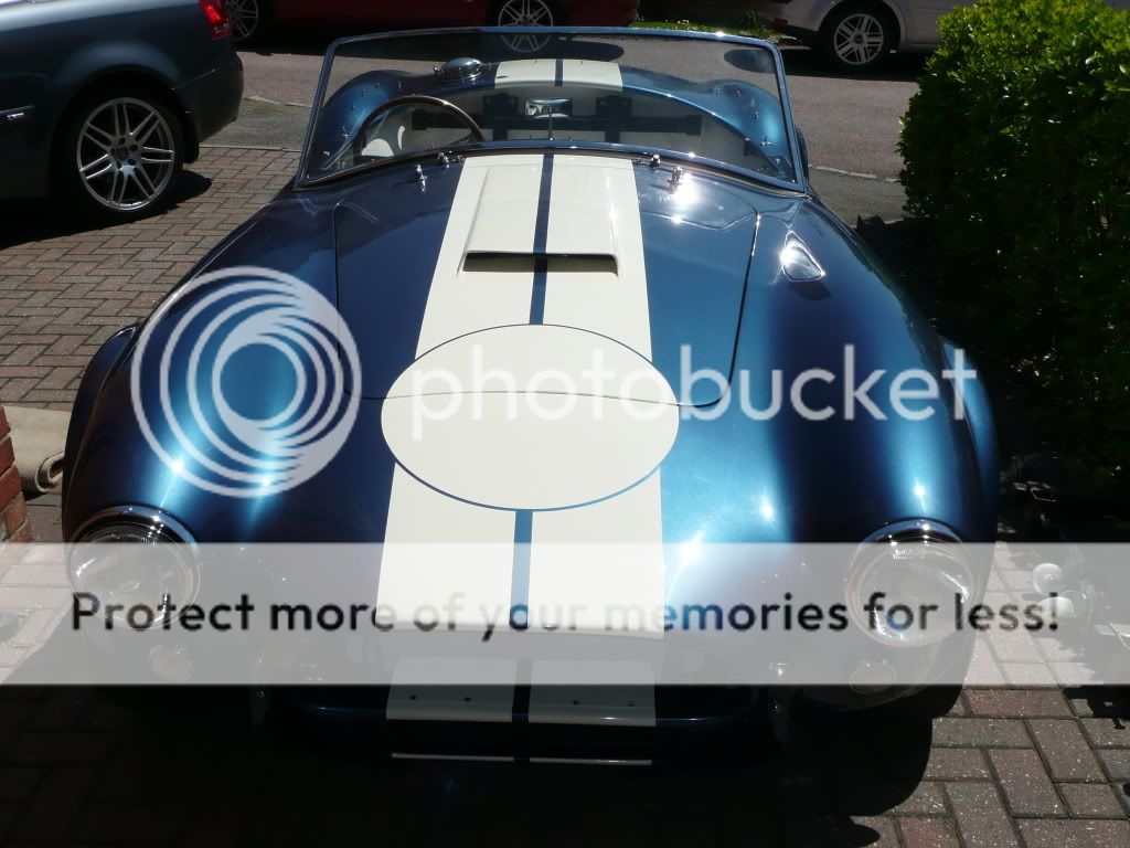

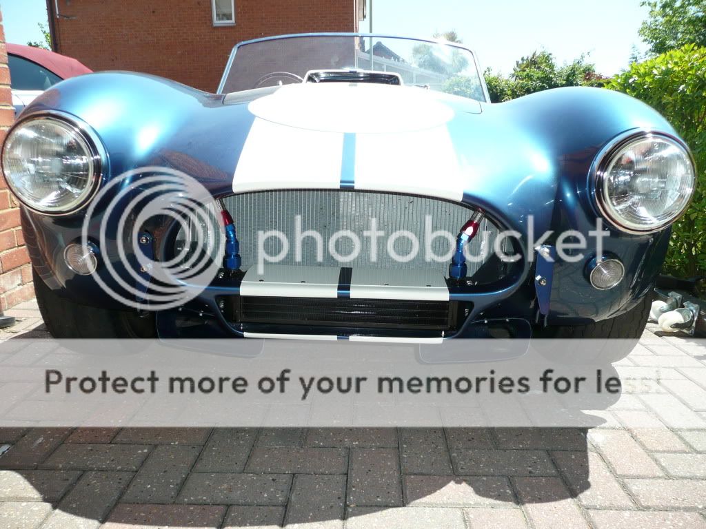

Post by andyg » Fri Jun 11, 2010 8:35 pm
A couple of photos showing my rebuild progress
Images courtesy of photobucket - thanks again Clive!
Andy
